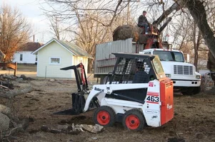

Them little buggers can really lift. Heres a smaller Bobcat and a log this guy never had a forwarding machine in 20 years of doing tree work. he called me back so happy when he got his machine and grapple. His first day he Cut a full day of humpin brush & logs (by hand) on a tipped over oak to less than half a day. He said it felt like he was cheating -he & his partner couldn't wipe the smiles off their faces.

They are a great tool. Save tons of back pain and they don't complain after working all day.
Our's goes with us to almost every job, all it has to do is get it close to the grab truck.
