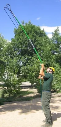

My shooting stance for the BS.

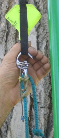

The single biggest hurdle I faced was finding a method of releasing the snap shackle without pulling the pouch off aim while pulling the release string. With the snap shackle I'm using, I've pretty much got to hold the shackle while pulling the pin. I've had good results with just about any bag I put in it.
When my Dad was teaching me to shoot .22 and shotgun he talked about breathing. Same thing applies for shooting the Big Shot. When I miss its generally because I yanked the string release instead of 'squeezing the trigger' as Dad said! I hear his voice when it happens too :)
I copied Tom's MA setup too. (Thanks Tom) I'm using a 10oz sherrill highball most of the time. I push the rubber for the finger grip to the side and put the shackle next to it. It's an absolutely deadly setup.

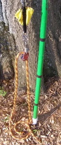

I suppose I'm a bit late to this, but in my experimentation I found (what I think anyway) is a better and simpler alternative.
Really, the thing about pulling back the BS is not the mechanical advantage, it's the progress capture that's important. I got tired of having a mini-traxion flailing around after I pulled the trigger, not to mention having to scavenge it to use for other stuff.
I started using a piece of 1" tubular webbing tied in a klemheist onto the pole. Slide it up, clip the shackle in, and pull down the BS pouch and webbing at the same time. The webbing will grab on the BS pole just like it would on a rope. It's very easy to get it all the way down to the bottom of the pole, no MA required.
I'd recommend making your own endless loop using a water knot so you can get the length exactly right (for maximum pull) and having the release shackle inside the loop.
Hope this helps.
As Treewill said, it's the sliding holddown that's key, no MA required. The different between that and just pulling and holding with your arms is you can aim carefully and release smoothly, makes a huge difference in results.
