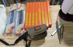

I did, however, pick up a bunch of stuff to sharpen on the jobsite, if necessary. I've just found that I'd rather change out the chains. This batch of stuff I got for the trailer I use to haul my tree shit around in... and haven't used any of it, yet. I've been thinking about building a bench in the garage of the Stromsberg house just for working on the chainsaws, so maybe I can put it to use that way. I have a spare chain grinder, too... but I really don't like the job those things do. They are fast, and fine for sharpening the older, more worn out chains.
