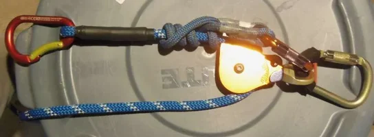

I assume you want to use a prusik for progress capture, like below?
Isn’t the 90 degree corner on those for tending prusiks? Probably no difference, the cheek plates will scoot the prusik along just as well.
@Ryan Keats looks like a kick ass setup, I’ll likely get the same pulleys eventually. Like Jeff showed, they’ll take multiple biners. Also the swivel eyes are nice and rounded, cordage friendly so you could have one spliced right on a loopie or an eye. You gonna just leave them setup with the rope already in them? I use a lot of 1/2” rope for rigging, so I just put them on whatever rope I already got in the tree, but already put together with rope and stowed in a bag sounds nice and fast too.
The Aztek kit looks so sweet and I believe there’s a built in cam for progress capture on one or both pulleys but I just can’t justify that kinda cash on something that maxes out with 8 or 9 mm cordage.
Yes, it is... and it helps... I had some of the OmniBlocks out, down in the basement, and just slapped a prusik cord on there to snap a pic. Wasn't even thinking about it. Works better if you use the 90* corner for the load side.
Look at Jeff’s pic, when looking at the Orange side of the Omnis on the lower left of them is a corner, it’s there for prusik tending but not really necessary. I don’t think they put it on the 1.5” ones.
Sure HTP should work fine.
Yeah, the 2.0 and 2.6 have them, but not the smaller 1.5 ones. All 3 of those are in the pic.

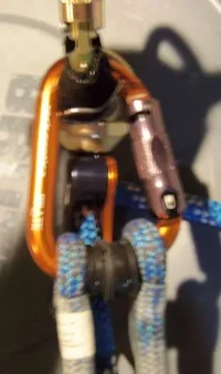

Also, when doing this, the eyes of the prusik will rub on the rigging rope. That's not a good thing. An easy fix is to buy a pack of regular garden hose washers at the dollar store and use about six of them between the eyes of the prusik cord on the carabiner. The rope will rub on them, instead of the eyes, and they just spin.
