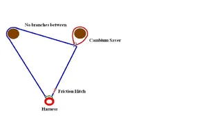

Has anyone tried the Triangle Redirect? It is basically the "M" redirect, but without the biner or pulley. If there is not any branching in between, wouldn't this make more sence to save length on rope? Or does the triangle redirect not feel stable enough?

Tried that. No its not as stable. Too much inward force applied to the TIP and Redirect points.
The "M" keeps the forces downwards in the more usual manner.
That is what i found. i much prefer a 2nd line; even a rig line; and a muenter/ muled for stops. Calculating that as long as most weight and life dependance is on real life line and 2nd line gives better direction or stability i'm 'legal'. Dual use is having lifeline that will pull you out of trouble/ away from load if necessary; and rig line over load; helps also bring you to load. This line can also be ground operated IMLHO; as long as you are serious about maintaining full life dependace on legal line and use rig to bring you to load. Will use a rigging krab sling to give more stable or comfy positioning too; but will always know that it can be questioned; and maintain serious attitude of lifeline support on lifeline proper.
yse it would save on rope but you couldnt retreive your eye if you wanted to drop the re-d but keep your original tie in, which the "m" will allow

Its worth bearing in mind with the 'M' technique, that if the anchor point fails (usually used out along branches so entirely possible ), you could fall a very long way and suffer a huge fall force on a doubled low stretch line.
Very very not good
I don't teach it for this reason.
