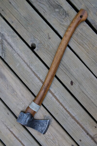

@Shadowscape
At your leasure, perhap you could have someone w/ a Cell Phone take a couple pics of Roxanne & the handle ?
@GregManning
I will break out my camera and do that for you. Not likely to see anyone with a cell phone for a few days.

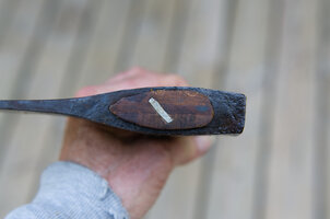

Here you go... Roxanne
You are going to ask about the handle, so I will tell you before you ask. It is quite a bit straighter than the standard forest axe handle that comes on them. It may not be noticeable so much in the picture, but if you put it side by side with the normal one you would see the difference right off.
Oh, and I was wrong. It has a flat steel wedge. My felling axe has the round steel wedge.
And if you are interested in the cordage, it is just cordage that was dipped in epoxy and wrapped on. It is that spot where everyone splinters their handle. Something I put on several years ago as a little bit of protection.

Thanks !
The head wedge(s), look like both wood, & then the metal added ?
I wondered about the "metal exclusive throat collar" to protect the handle. only on the splitting mauls ?
