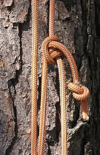

I use that often MB with the other end of my lne - very quick and effective.
What is your experience of 3 wraps over 4 and how heavy are you (its relative)?
MBs knot is two down, one up.
That is the knot I learned to climb on.
I am fairly confidant that I could tie that knot while upside down, in shock, bleeding, or if there was a major earthquake and the whole world turned upside down.
It is good to really know your knots, no matter what.
