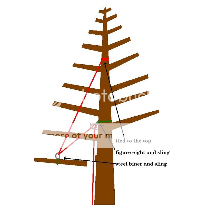

this is what i have been using for small stuff like pines.
you can use a hand full of slings and carabiners. this system allows our groundies to stay busy. all they need to do is un-clip the biners on slings and send em back up to the climber. i use 5 slings because i like taking more then one branch at a time on pines. if im doing 5 branches ill girth the slings to the branches im cutting, clip the carabiners to the rope and then have my groundies hold the rope taught until i cut the last branch. then i give the all clear and they can begin lowering.
A variation on Josh's figure eight in a tree is to set up a double whip tackle.
http://www.smackdock.co.uk/tackles.htm
The load on the down rope is halved and the lowering speed is halved also.
When I used this system the groundie would take just a rubbing wrap on the tree to assure that there was a bit extra friction during the lower. When the piece hits the ground the groundie detaches the sling and yards the floating pulley back up to the climber. Using the F8 in the tree makes yarding a challenge or impossible. Also, the floating pulley doesn't incorporate hockles into the rope.
