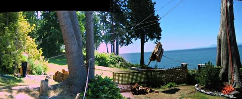

We did this job a while ago so I thought I'd finally post these pics.
Just starting in this pic.

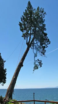

Most of the lower brush off. Cedars are terribly tangly making the rigging a pain using a zipline set up.

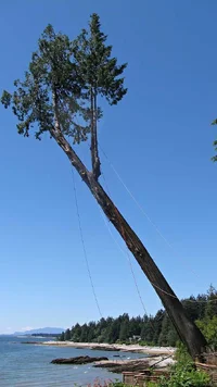

Done for the day. We actually spent over two days on this tree, slow going with all the little limbs on the speedline, even bouquet style, and then a good drag to the truck. We split and hauled all the wood as well. Used a little Muck-truck to get the wood up the hill.
