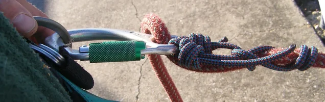

Re: Lanyard adjuster Version II
Life moves forward in small incremental changes. Evolution isn't just for biology or theology.
The original adjuster had a lot going for it. Compact and easy to use. But, because of feedback from Mahk about the concern for the scaffold hitches interfering with the locking of the sleeve, Taylor's concern about triple wrap SH and the suggestion by FHFR of using a captured eye snap I spent some time mulling over what has become the latest iterration of adjuster.
The biner that I used was in my bucket so I didn't even have to buy anything. The hitch takes about 40" of Tech Cord.
Thanks for the feedback, the adjuster will get it's maiden flight on Saturday. It passed initial Low and Slow tests already.

Nice Tom! A place for everything and everything in its place. I struggle myself with using triple scaffolds but, it just makes me feel better.
I think it would be fun to see a picture of that bucket!

I tried the setup you displayed today, with a short VT and it worked great. Very light and only a bit slower without a pulley.
