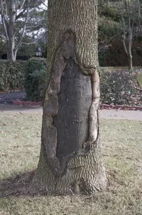

Here is a recent picture of the trunk wound that I treated. I took this picture last week. The first pictures taken at the time of treatment were about 2 years ago.
No cracking in 2 years without reapplying. Good deal--facing north?
1. Cracking is stopped
2. Infection court is smaller
3. Tree devotes resources to smaller area and can codit it better.
Makes sense.
BostonBull,
I can't say for sure how much can be attributed to the lac balsam. It is a white ash growing in a very wide tree lawn. There is irrigation on the property so the tree does not suffer from drought stress.
Guy,
The wound on the tree faces west.
Did I mention that the wound was caused by a car crashing into it. This is the tree that stopped the car, the tree next to it, also a white ash but a few dbh " 's smaller, was damaged similarly.
