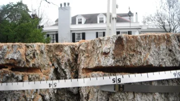

I should have clarified the pilot cut. It is not a power issue but rather when making a stump cut when the saw is horizontal, with a 59" bar the flex in the bar will throw the chain off if you do not have the cut started. Also I find it easier to start the face cut and the back cut with a smaller saw. Takes 15 seconds to switch saws. I have that 880 off the shelf 2-3 times a month.

P.S. Maybe pilot cut is the wrong term. You know what I mean ,right. What would be a better term? What would be a better technique to start big cuts? Been fine tuning my collection for years. Us tree guys sure get wrapped up in our saws. Makes my wife crazy she thinks I am excessive. She doesn't get it.
