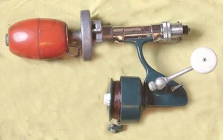

Yes, Nate. The retreiver trainer 22 cal. dummy launcher for training dogs. Stick a fishing reel on the device and fix the line to the dummy and viola your launching line to 150' plus. It was the first homemade line launcher I used. A compact device and easy to set up for shooting, but it makes a lot of noise. Much more than the CO2 launcher. Click the attachment for a view of the device

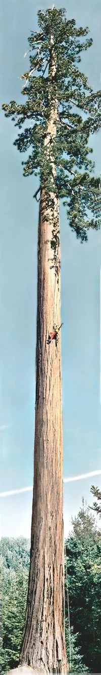

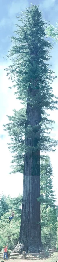

Here's a image of the first tree I used the launcher to set a line in, back in 84. Called the Standish tree. Line is set 160' The tree is a fatty 15' plus x 250' tall. This is a panorama. I'm not sure how it's going to upload on the board. Here goes
