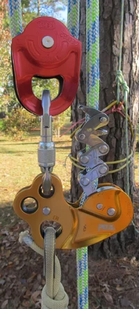

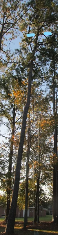

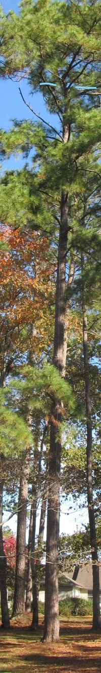

I enjoyed a nice 60' climb in this morning, and I made a change to my climbing rig after I got down.
Pic 1 is the tree.
Pic 2 is the upper pulley arrangement.
Pic 3 is the lower pulley connected to the ZZ with a Petzl Oxan carabiner with a load on the loop that goes to the harness. Looks like there is just enough clearance between the pulley and the ZZ release. BUT...

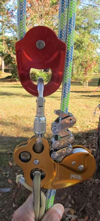

Pic 4 shows what happens when I pull down on the rope to go up. The ZZ rotates so the ropes rub together a little. I think it will probably be OK with all my weight in the harness, so I'll give it a try on the next climb.

Here's a simple low-cost equivalent to what you're currently climbing on. This is out of the Peter Jenkins/Tim Kovar rec climbing tradition, they call it the "Super System", a 3:1 MRS to help first-time rec climbers who have too much have trouble climbing a 2:1 MRS. The "split tail" in this configuration sets the pulley further away from the climber so it doesn't get in the way. Now I'd just use a double fisherman's noose knot on the carabiner on the micropulley instead of the backed F8.
Don't worry about "climb stroke" distance with your split tail from the carabiner to the hitch, you can climb continually on this system until you want to rest, no need to sit back after every pull cycle. One hand pulling above the hitch, one hand pulling below, the lower hand pushes the hitch up as you move up, "stroke length" becomes irrelevant.

AJ, it looks like I could substitute the ZZ for the Blake's hitch in the picture. The weight of the line below the ZZ would be enough to pull it through the ZZ once I got up a ways. Until then, I'd have to hold my position with one hand while pulling the line through the ZZ with the other hand. I'll have to see if I can hold my position with one hand on the rope.
The ZZ gives up an inch or so as it tightens on the rope, so I think fewer and longer strokes is a little more efficient. The hitch may be better in that regard. It's been a while since I climbed with a hitch.
