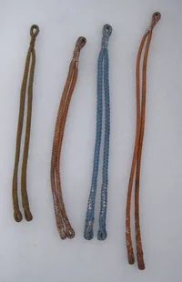

I just came across this picture. 6 or 7 years ago we had an exhaustive thread going on how to back up dual ascenders.
Nick went as far as to create a new eye-eye-eye, a tri-clops(?), for approaching twin line backup it in a way that, as far we knew, hadn't been done yet.
When someone can splice 11 mm KMIII, let me know.

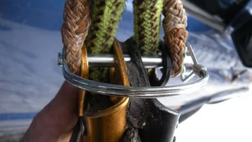

On a side note, I don't suppose you would have interest in thoroughly abusing some products for me? I am anxious to have some rope bridges put through every last possible ringer and I have a good feeling that you could come up with some tests that would be significantly "outside the box".
I need a 200' Stable braid of 7/16" (11 mm) diameter, both ends spliced, one tight eye, one 4" eye. I call this rope "Stable Eyes". I am willing to commission this to someone, anyone......
.... you could come up with some tests that would be significantly "outside the box".
[/ QUOTE ] Anything I would do with them would be outside the box of how they're designed to be used. I have no problem 'abusing' some gear, send it on.
If you are interested just let me know where to ship the bridges and I will get them out to you.
That's OK. I handle friction quite differently than other tree climbers, and probably wouldn't put the bridges to any sort of conventional use, but as far as being an extreme end user of these products, I am probably the least extreme. I do not climb 2:1, except downward, and only occasionally, and my friction pieces are metal and minimal, they take 5 seconds to off / on them and if I can beat that swiftness and ease, I am all about it.
A spliced product (other than a rope) will last years in my hands. Honestly, I'm a terrible tester guy for spliced products. I climb with things people have never seen, spliced products for me are accessories, not the VT workhorses that most of you pro climbers use them for. I'm a metallian climber, and though related to my hitchand2:1ian brother climbers, I'm a mutant.
Blinky would make a good tester. You should send <u>him</u> a bunch of stuff.
