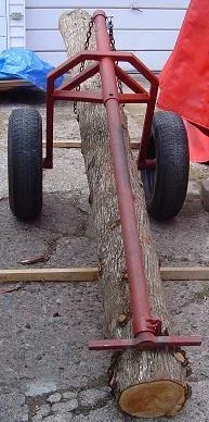

FFP does make the primo log arch. If you can weld you can build a log arch for yourself. If not, sketch something up and get it to a welding shop.
do you have an ATV? They can move a huge load.
Dig up the parts and get a local welder to build you what you need.
This isn't a trade secret, they have been using these things to move steel pipe around the steel mills for a long time.

Paul Howard, a friend and arborist in Munich came up with this concept (see attachment). We've been calling it the H-Booster. It's beautifully made by a mate of Paul's in Bavaria, and I can tell you it's bomb proof! Talk about massive! It's really ideally suited for work in european urban environments, where we often don't have sufficiently wide accesses for machines.
In it's basic configuration the H-Booster is a log dolly, you can extend the handles by about 1,5m to increase leverage. There's two different hook designs, one to transport logs standing and the other to load them sideways.
The first picture shows the H-Booster in it's basic configuration. The hook also doubles as a cant hook. Handling logs is really easy. You're really only limited by the width of the access.
