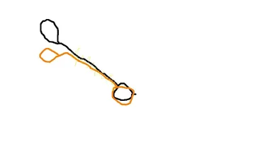

I'm almost thinking I could do a basic eye and eye and then insert a separate ripe into the upper eye and create a continuous loop from that.
sorta like the attached pic.of course the blue part would be buried in the black part of the eye.
Doing it this way would preserve the integrity of the eye & eye splice and keep everything together.
Rick,
FWIW, below is an option that sorta fits your diagram. Sometimes a <u>seized</u> eye works for a mid-line eye. Either leg can be loaded. Caution, though, if both legs are loaded they must be loaded in the same direction. I don't know if it will work for what you're doing ... just a thought ...

This is a fun one! I have 2 ideas. Does the third eye have to hang separate? Can you have 2 eyes stacked one on top of the other?
I don't think this is the place for the whoopie.
Can you show a pic of it in use? In my brain I can envision the setup.
Nick,
If I could show you a pic in use, I'd not need to figure how to make it!
In essence what I am trying to do is take a long tether and a short tether and make them out of, or into one dual purpose tether, leaving the long tether attached to the saddle and lockjack at all times and the short tether attached to the lockjack at all times but to the saddle intermittently.
This way I can extend and retract the longer tether without ever having to disconnect it or having to safety in first.
That make any more sense or easier to envision?
I think I know exactly what Nick is thinking and I was thinking the same thing is why I asked the purpose. What you can do is something similar to the anchor bridge system or the footlock prussik that Nick spliced for me a few years back. Basically it has multiple stacked locking brummels creating multiple holes for attachment.
the problem with the stacked brummels PU is that I'd be loading the throat of the splice. From what I gather that is a big no-no as it causes severe angular loading of the fibers.
When I discussed it with Rich H. he agreed.
What about 2 seperate cords, one long one short, whipped together where the eyes on one side are together and the other side the eyes are offset??
that pretty much is emerging as the way to go.
