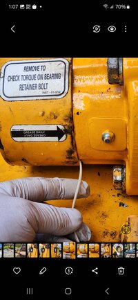

I didn't think to take a picture of this when I first opened it and it was packed with mushy grease. But here it is showing some rust including pitting rust that's been working in there for some time.
Guess I'll pull the dust cover again soon to check torque and then go to every oil change to wipe out excess build up near seam/crack.
