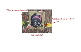

I like your Mini-GRCS. Nice work. I too am thinking of making my own. The attachment I have is your Mini-GRCS with arrows pointing to two D-ring shaped bars. Can you tell me what their function is? Thank you.
They are rope guides.
Copied directly off of the original (MIGHTY) GRCS!
Just check out the GRCS and you will see why and how these help with roping side loads.
If you have further questions please feel free to ask me via PM (like you did already) I welcome questions.
