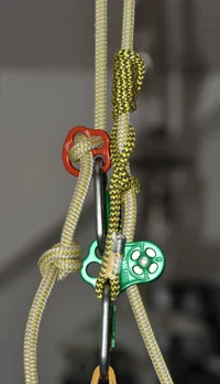

I recently ordered a hitch climber setup (have been climbing on a taughtline hitch forever) and I am curious about termination knot possibilities. My climbing line does not have a spliced eye, nor do I really feel like spending the money to get one at this juncture, but I am aware of the potential problems with the termination knot affecting the friction hitch. Is there an alternative termination knot that can be used that will not affect the friction hitch?
I have one line too w/o a splice came up with this:
It doesn't interfere with the friction hitch, all is in line and it offers quick on/off. I guess that it will also absorb some energy if a shockload happens.
is has no rubber inside the holes
Lol well I need my glasses then, I am going to get one of this plates cause I hate to use the hitch climber pulley when my rope doesn’t have an eye, o well, I love ropes with no eyes when I ascend SRT and then work with the Spiderjack 3.
