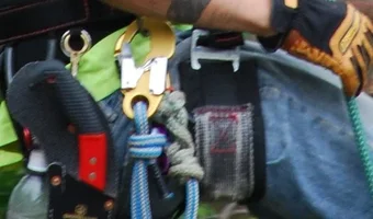

I have been climbing for a few years now and I have used lots of diffrent types of lanyars. I have the Distel tied up on a blue streak rope backed up with a micro pully right now and it seems to be working great. I switched out the 1/2in. blue streak for a thinner CMI rope, my problem now is that my friction hitch slides back into my micro pully and jams it all up. Any Ideas??? I cant find a smaller pully anywere, the smallest ive come across will take a 1/2in. rope. nothing smaller. You can kind of see what my set up is in the pic.

Hollenreich, that is a good idea. I may be a complete idoit but I cant completely wrap my mind around what that would look like. Do you have you lanyard set up that way, if so maybe you could post a pic?
you can do either, a delta link works good for this, tied to d ring, or spliced on. run rope through ring and d ring attach end to saddle, tie hitch beyond ring.
there is a pic of it in the 'lanyard set ups' thread..
