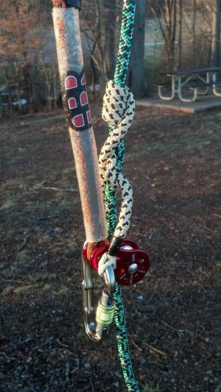

Here is the Knut /Michocan 4/1 freshly dressed.

I stopped twice to loosen the hitch but it seemed to lock up if I loaded it too hard. Overall I was a little disappointed in the hitch. It seemed to work fine for descending but I had to un-weight it before descending. I need to compare to the VT and XT and XXT but I was loosing daylight. For some reason it seemed to tighten even after re-dressing twice. Suggestions?
I'm just gonna say that something looks weird in regard to the eye splice in the first photo. Is that a Locked Brummel? It looks like the braid is opened right up quite a bit. Maybe I'm just seeing things...They look more normal in the second photo.
Yes.... I am still learning. I wasn't sure which way to run the core through. I figured out what I did on the next splice. I was flipping the fibers the wrong way. Basically it is turned inside out instead of outside in.... Lol. I feel it is purely cosmetic but correct me if I am wrong. That's the only one that came out that way.
Cool, so long as you know what happened. I'd be concerned if there wasn't any critical thought behind it...please, no offense. It's only our lives we're concerned about.
So, if you find that it binds, try the next size up in hitch cord diameter, which may be a bit of a trick due to your climb line diameter. Is that Yale's 'Bandit' (11mm)?
Yep.....Yale Bandit 11mm. I did try a 5/1 again tonight and bounced on it hard. I couldn't get it to lock up once. Maybe I should listen to you more ...lol... the short 4/1 is nice and compact and graps quick but IT HAS TO RELEASE. I am making a 28" 8mm Beeline and see how that does. I have a 25 and 33 at the moment. I had a 30 and 28 with knots but they seemed bulky.
