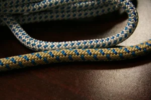

Only beeline has that checkmark shaped tracer, though. Just a really bright picture of the new Vectran core stuff, looks like. And yeah DBT is on the money for recommended splicing, since the core is 100% class II rope.
Nah, I think the UK and US have the same stuff. The Samson Prusik cord just has a straight line for its tracer, but the Beeline makes the check or L shape. It's amazing how much those two pictures look alike in color though, cause I'm looking at the real cords in person and they're pretty distinct.
Nick is that stuff really gray and blue? The stuff we have looks almost beige or gold- see attached.

nice one, great to see 2 cords together so the colour/camera does not change the tones.
Yeah, I was also thinking that. Maybe it's just super frayed out. I pulled the core from the beeline and mussed it up a bit and it kind of resembled the first picture- still looks a lot like a polyester or even nylon material though. Cameras do weird things...
