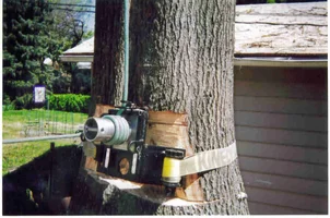

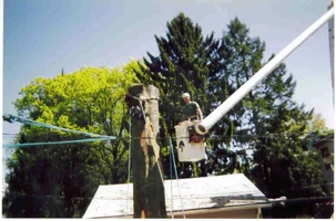

We had a GRCS malfuction twice on the same job. Big jon was blocking out some pin oak when the GRCS came flying up at him. This was a first for me, I've have used it many times but have never seen the strap come undone. We reset the GRCS notched into the tree. We had three guys ratchet down on the strap and it still happened. Thankfully no one got hurt but left us scratching our heads. Both times the cam device popped out allowing the strap to release and senging the GRCS up the tree. We have now modifided the cam and drill a hole behind the cam in the locked position. The hole was threaded so we can thread in a bolt behind the cam not allowing it to open. Posted picture or GRCS up the tree.

Roger, we blocked out the wood because of an asphalt driveway. The garage behind the tree was downhill and only about 8 feet away. I didn't want to take a chance of something bouncing into it's side. After we had the two mishaps with the GRCS, I put a couple of pallets into the drop zone. I know a little messy, but worked on short notice. Starting cutting two foot sections and just push them off. Axman, in the picture of GRCS mounted to tree you can see the bololard in place. A little damage though, with having part of the Aluminum snapped off.

I was just wondering if it is possible for the cam to jump out under the intial shock load of a piece of wood. My thoughts were that the shock on the strap around the tree as well as the strap coiled up may stretch allowing the cam to jump out. I thought the load on the rope would excert more force on the strap than three guys on the ratchet bar. Greg, I do believe the ratchet and cam are still working as origianaly intended. I just think a better design should be employed to kept the cam in place at all times. The damage to the GRCS was relatively minor, a broken bollard and a peice of steel at the top of GRCS that you feed the rope through broke off. Both Items have been fixed as well as some of the groments in the back replaced.
