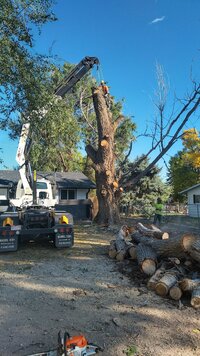

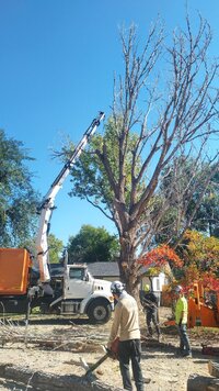

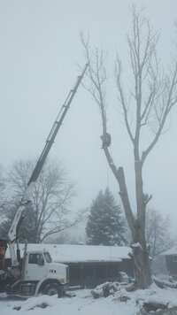

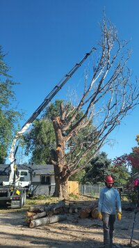

Alright looking for some input on an upcoming decision for me.
I finally got around to adding a remote control and two extra valves on my knuckle boom (was definitely not cheap or easy, but way worth it). So, now I can theoretically run hydraulic power to the end of the boom. I have ordered the reels, but they are a month out, so I'm waiting on them now.
My main consideration is whether to just add a grapple or to bite the bullet and go for a grapple saw.
I am only a contractor now, no employees. My current rate for my crane is 175 an hour. If I got a grapple saw I would want to make at least 250, probably more. Some of my clients have expressed they'd want that, others say they'd rather climb and save the money because they're climbers and that's what they do. I'm open to comments on my pricing. Most people hire me not because of the size of my crane, but because of my experience in the industry doing hundreds of crane removals on both sides of the rope. ....it also helps I can haul all the material for them.
My first concern with the grapple saw, other than price is whether my crane is big enough to really make it make sense (see load chart below). I'd probably go with the sg160 vs the sg220 due to weight, which would mean a significant amount of most trees would need to be craned out anyways.
My other question is if some of you guys that own this stuff could show me some pics of your reels and your hydraulic quick connects. I want to get an idea for the best way to set mine up. Luckily no welding will be required on the boom, there are threaded holes in the right spots. I will fabricate brackets and bolt them on. I am just looking for some ideas about hose orientation/routing and the quick connect on the end so that it is easy to remove and replace the grapple.
I'm open to any and all comments on my situation, so lay it on me and thanks for any thoughts on this.IMG_20221012_112331_MP.jpgScreenshot_20230107-180101~2.pngIMG_20230102_092718_MP.jpgIMG_20221012_153512_MP.jpgIMG_20221012_142709_MP.jpg
