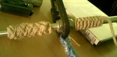

I tried a couple things to fatten the handles a bit. I know which I prefer right now, but I thought I'd throw it out to you guys and see what y'all think.
Click on the pic and you can see that the left side is a turk-headsesque type knot (not exact because I've not practiced much with the turks head). The one to the right is consecutive square knots (or maybe they were granny knots).
The plan I have, after trying these two is to do the consecutive overhands, then when I get to the bar, go over these overhands with MORE overhands to fill in the small gaps between the bars and add a bit more thickness.
I did this in hemp. The final copy will probably also be hemp, but presoaked and stretched so it stays super tight on the handle.

Re: Phase 2 complete
That's a good idea Mike has. Easy to try and see if it helps? Plus you're pretty good with rope, no? If that doesn't work good enough, whip it with some leather strapping that you have from that stuff you made for my grcs.
Mark, now that you mention it, I could do the first layer of overhand knots, than shrink-fit-sew a piece of thick leather over that. The knots underneath would give the leather some really cool texture!
I wonder how it'd hold up in the rain?
love
nick
That's some nice looking fancy work Nick. Good to go back to traditional ropework and blend it with modern tools.
I like the idea of covering with leather. After reading Brion Toss' book I've wondered where that could be incorporated into arbo gear. I'll bet there are some leathers that are treated to work in the weather. After stretching and drying I'll bet some kind of treatment could be worked into the leather. Silicon or some other juice.
I like the looks of the right handle.
Nick, very nice work. If you cover with leather, I think the leather will lay better on the one on the right and be more comforable to grip. For a sealer, I wonder if you could use a water based poly-urethane on the leather. I don't think it would be too slick because of the pliablilty of the leather. If it was, you could give it a light rubbing with some 400 grit sand paper to give it a little texture.
Jim
