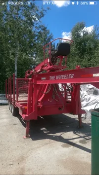

Thanks. I totally agree that loading brush in a trailer is time consuming, inefficient, and enraging at times. The nice thing about them is the ROI is really good.
Paying someone to chip can be a good option if you have the right agreement with the right person but then you are depending on someone else to get your jobs done. It’s nice to not have to depend on others to complete your jobs and allows you more flexibility with planning / scheduling. You also get to keep more of the $.
I’m in the same boat re used pick ups. I live in Toronto and everything is salted all to hell so you really are left looking for a diamond in the rough. Almost everything has high km and has been beaten to hell not to mention they usually want way too much for them. Like you, I can’t wait forever for the perfect truck. It’s tough to find the overhead/equipment/efficiency sweetspot when it comes to a part time gig. Especially when the cost of living is as high as it is these days.
So I ended up getting a 2018 Silverado 2500, crew cab, 6ft. box............. diesel. I ended up getting a huge discount on it and I sprung for the extended comprehensive warranty for 5yr/ 100,000. I had a hard time deciding but figure the diesel is better for towing a large trailer, will get better mileage and will have higher re-sale when it’s time to sell.
I have given up on the idea of a SRW HD pick up for a chipper truck which is why I went for the 2500 6ft. box. As many others have stated, you are pretty much guaranteed to be frequently overloaded with that setup and I can’t have a dually as my daily driver.
I’m going to go the pick up and large dump trailer route for now and see how it goes.
