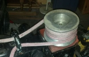

That looks almost exactly like mine did, Stihlmadd.. LoL..
Yeah, for light rigging I would think the aluminum would last awhile. I know we pushed mine too hard. It did cool better than the steel ones, I think!
