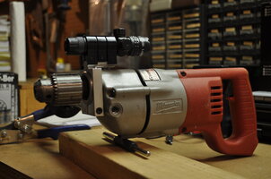

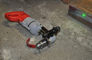

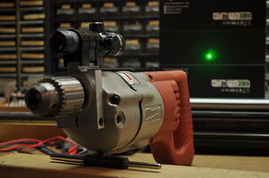

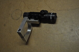

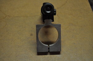

Laser dot mounted on a drill. Custom made mount mounted on a Milwaukee drill works on straight and right angle drill heads. Laser is $20 green dot specified as less than 5 mw. No problem in bright sunlight. I would get a 1 mw If I purchased another as the 5 is a little too strong.
