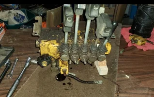

My mini is back up and running and back in the "this tool is awesome category". Ended up being a blown o-ring in the control valves, $1.06 fix and an even easier fix than a sheared key, once diagnosed, that is.
How did you diagnose it? Any short cuts if you had to do it over?
Ended up being the same issue that I had the previous year when it broke down after 2 hrs of use.
When I originally diagnosed it I removed the control valve assembly and broke apart the 5 controls and 2 end blocks. Ended up finding a bad o-ring in the end block where the hydro fluid enters and exits the controls. After reassembling I found that the port with the blown o-ring was assemble from under the hood.
So this time around that was one of my first checks was that o-ring and I found that it was bad again. took 5 mins to replace once the machine was cooled down.
20191230_072033.webpcontrol valve assembly removed from the machine
20191230_072047.webpbreaking the valves apart from each other. 20191230_072110.webp the cause of the problem 20191230_072135.webpand the location of the bad o-ring.
When assembled this is accessible by opening the hood and reaching in with two 12" extension on a 13/16" socket. Replace o-ring, retourque the "plug" (not sure what its really called) and get back to work.
During disassembly of my machine, I found that some of these ports have spring loaded ball bearings and cone bearings which are easy to send flying with disassembly especially if the control unit is still on the mini skid.
