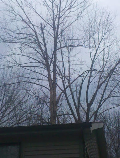

These trees are at a clients house. They met with me 4 years ago and decided not to treat for EAB. One of our CA's was here last August and the trees looked normal.

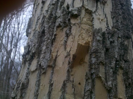

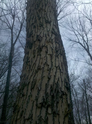

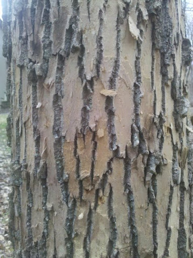

Woodpecker damage seems to be one of the most visible symptoms of EAB... This is the most extreme example I have ever seen! There were at least 15 ash trees with this type of damage.
Treatment was very costly due to the volume of ash on their property. They are planning to move in about 3 or 4 years. Their hope was to sell before EAB arrived. It was a gamble... they lost the bet. Now they have a costly tree removal project instead!

I have heard this termed "shredding".

Last week I was on a client's property checking out some trees. Last year we treated 4 Ashes in his back yard. Behind his yard is a row of old, like 80 year old Ash trees. All of those trees had woodpecker damage from about 6 feet on the trunk down to the ground.
