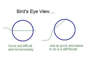

As far as needles for stitching your splices, I reccomend the ones in the green packages. I found mine at a tiny sail-shop. "Bainbridge" is the name of the company (I think) that makes these.
The needles that I've seen that come from Sherrill are just too darn big...especially if you decide to splice stuff 3/8th and smaller. And these Bainbridge needles are not cheap. I bought a set of 5 needles (all different sizes) for ten dollars....but it was SOOOOOO worth it!
And regarding what size to use...A rule of thumb I use is that the needle should be slightly annoying to thread. In a throat that is tight, a smaller needle will go through easier. If it threads too easily, maybe the needle is too big. However, if it goes through the rope easily, then that's good enough!
Oh, yeah. A common mistake that a lot of people make is they try to send the needle right through the middle of the rope. Remember- all that is necessary is to lock the cover and core together. Going straight through can be hard sometimes.....check the pic to see what I mean.
Okay, I think that exhausts what needs to be said about needles right now. Keep the questions coming!
