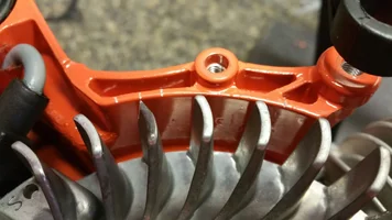

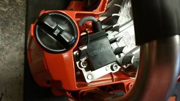

Once modded to this level, the rev limited coil really needs removed. There's not a bolt on replacement, so a Husky 272 coil is used and the flywheel re-indexed.
I also installed a larger carb from a372XP XTorq. This requires a significant number of mods which I'll not detail here.

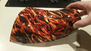

Here are the final graphics on the covers.

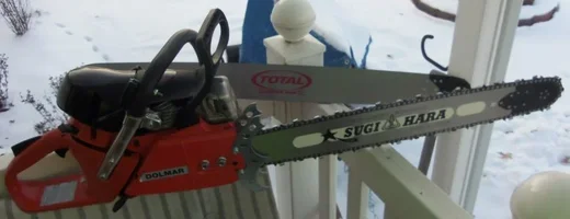

Actually, Brad, I didn't know you carried the Light & Tough bars! So I got a 24" Sugihara and 32" Tsumura/Total Super Bar (not the L&T one) for it.
I'll have to get with you, as I have other saws... :)
