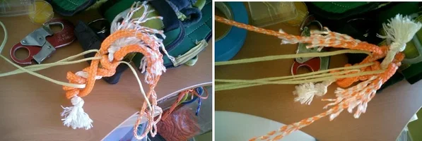

And here's the after shot....
This thing was a pain in the butt to do, but it seems like it'll be a nice setup. Much like those of you who are tying your friction hitches directly to the D, except I spliced it.
I have a CMI slack tending pulley that I've modified so that it can be attached to the dee without any other hardware involved. I am going to try it without any slack tender for a while. Tom's been ranting about just using the dee as the slack tender. If I don't like it, I'll pop the pulley back on.
The friction hitch is 1/4 inch Yalex (ABS 2500lbs) and the flip line is 3/8ths Double Esterlon (ABS 5400lbs). At first I thought it was going to cinch down super tight and not be able to let slack out while it was weighted. I guess since both the flipline AND the friction hitch are of smaller diameter, the proportion is good and it still tends and lets out slack smoothly.
We'll see how it works!

I normally don't like being pinned down for knot names as eveyrone calls them something else. Friction hitches are the worst. This is what I was originally taught as a french prusik. The knot just twists straight up the rope a few times, like the VT, except there are no braids. Then just attach the 2 eyes to the biner (or dee, in this case).
I tried this about a year ago with 3/8ths Yalex and it just didn't work. It was super tight. The new setup seems to be working as it should.

yes i did,looked a niceset up.
i thought it was something like a v.t
i was using a v.t but tried a knut instead because it was a more compact knot. its not as good as the v.t though, i may give yours a go tomorrow.
like you, ive just started tying to the d, but im having a few problems, certainly isnt as efficient as having it on a biner thus far, but im still tweaking things.

I've settled for a compact and removable setup that looks like this:
/ Oskar
Oskar,What hitch is that & how did to tie it for that set up,I use a VT with pulley but my hitches are on the outside of the pulley not in like yours.
Ross, I call it a 4-2 VT or french prusik, whichever.
Insted of making fisherman loops on the ends I tied the ends
together to form a sliding fisherman's loop. Then I put one of the loops
(the other forms the VT) on a carabiner and inside a Petzl Fixe pulley.
The ends of the sliding fisherman are tied together with some (black) whipping
just to be out of the way.
