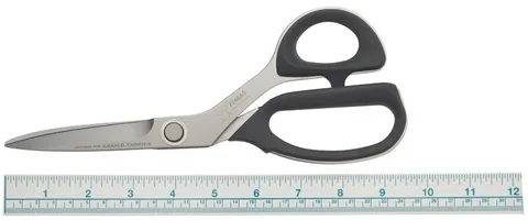

Check these out. The're made to cut aramid fibers. Think large sheets of kevlar sailcloth. The brand name is Kai and the model # is 7240-AS
