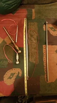

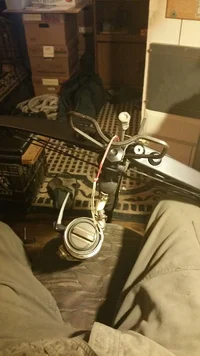

Uli Distel, designer of the Gecko climbing spikes, brought this rig with him when he and Bettis came from Germany to visit when I was working with Sherrill's. The big shot hadn't been thought of yet (I think it was 3 years later and that's a whole other story) and I needed something for a project I had with the New York Botanical Gardens in South America.

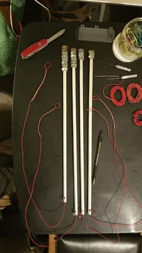

Solid aluminum shafts:
Solid steel shafts:

If you have not seen it you might be interested in my youtube video on crossbows for tree climbing. The heavy steel bolts are probably ok for relatively small trees, but are too heavy for long shots in big trees. And the solid aluminum shafts are expensive and easily bent. I prefer solid fiberglass bolts that are really cheap and easy to make from the 4' long fiberglass fenceposts that are carried by most feed stores. They cost about 2$ each to make. The bolts attach directly to a loop in the end of the spectra fishing line on the reel, so there is no need for separate tethers on the bolts.
