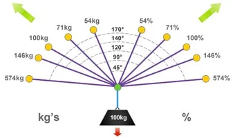

Same as in rigging principles, the wider you open your rope angle, the more you increase the forces - without actually changing the weight of the pick.
In the case of a crane pick you’re exerting more outward pull on the ring, and more diagonal inward pull on the tree branches themselves.
(I feel really borderline spydey after that last bit)
See the attached vector chart to get an idea of force multiplication
In the case of a crane pick you’re exerting more outward pull on the ring, and more diagonal outward pull on the tree branches themselves.
(I feel really borderline spydey after that last big)
I don’t see how the chart applies to crane slings, since each sling is terminated at the branch and at the hook. There is no multiplication of force by pulling midline. I can see how it would relate to a branch, except there is always a central line tied straight downward, negating the forces against branch slings, which then become mostly stabilizers. That may be the thought behind the team’s practice, as they always emphasized the need for the central anchor. Sure, there is some load on the branches, meaning load on the hook- not denying that, but it is considerably less than it would be without a center, vertical leg.
I’ve rigged tops with multiple balancers many many times and no central verticle leg. As those slings gain angles they gain them at the eye termination on the hook. Spread them out far enough and you crowd the gate and get critical angles on the hook.
the purpose of the shackle or master ring is to eliminate side loading of the hook and keep forces in the bowl of the hook where they belong
Yes that's what I said although you said it much more clearly. Now I reread my own sentence, it makes zero sense. So just to clarify you can still have critical angles on a master ring or shackle.

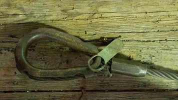

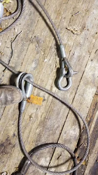

I would agree with steve... hard to have only one option...cable crane here, and i use cables for wood picks, unless a nylon eye and eye is easier for the climber and also won't slip off... in terms of cables, i literally have one for everyday of the week; including sunday on the truck at all times. 3 are different sizes with pass through thimbles, 4 are matched sets of 2 different diameters for "a" framing. My diameters run from 3/8" to 3/4"...cables bite well.
About 15 years ago i met with a master rigger at a large local supply house to discuss a wire cable setup that was like the ones used from our crane rental companies...which i also have. What i ended up with and use regularly are cables that have the same shaped thimble on each end. Each will pass through one another to form a choker...although i always use the one side with the proof tag on the hook, keeping it safe and also the cables last alot longer if only one end is used to form the choke.
