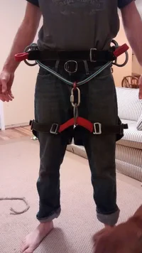

Made this mod a few years ago. I curently use a Tree Motion Light, but my friends like the mod better than stock. There is enough room to put the bridge under the side Ds and use stopper knots to adjust bridge length. Tail ends after stopper knots are tied together in back to complete loop.
