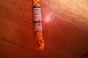

I had the same problem. I switched to a longer hitch cord and fed the legs of hitch cord thru upper carabiner (see photo). Works for me. Keep playing around with it....you'll find the sweet spot
-Chris

Chris, who spliced that Blaze? I like the whipping!
I spliced it...thanks for the compliment!
As far as a longer hitch cord, this results in a longer hitch. This helps keep the end of the hitch (the wraps in a vt) above the biner while the pulley is tending the hitch. I've been using a stiffer cord (bail out) also seems to help.
Also, having a tight eye splice (compared to a girth hitch, double fisherman's, or ancher hitch) leaves less for the hitch to catch on, IMHO.
-Chris
I think its a matter of keeping the top turns of the hitch above the termination point so the 'biner or splice doesn't
compress the hitch.
