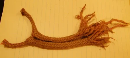

I thoroughly exmanined the cordage last nite. It's very obvious that it was cut. IG and I checked out the Petzl swivel and I pointed out to him the sharp edges on the black part. I am certain that's what cut the cord. Looking at the bridge under a 10X magnifying glass, you can see clean cut fibers. It should have been visible to the naked eye.
Also, it's a case of the wrong fiber for the application. Technora will abrade itself when the fibers rub together. While extracting the tapered filler, fiber particles were coming out, and the inner fibers were very badly abraded. All the urethane coating had worn off. Technora has poor flex fatigue as well.
This pic is of the removed (cut) bridge with the inner buried fibers. It's pretty noticible how clean cut it is. There were only 2 pulled strands. The rest were completely cut or partially cut.

Last pic. This has the outer halves side by side. Very obvious to see the clean cuts.
Conclusion: the strands/fibers were cut from a sharp edge, which led to the cordage parting.
It's also the wrong cordage for this application. Had the bridge been replaced with a manufacurers part, this would not have happened.
Lesson learned: have a complete understanding of the cordage being used and if it fits the application. Just because a cord has a phenomenal charring point and breaking strength doesn't mean it'll work in all applications. Always check with the manufacturer. It's your life.
