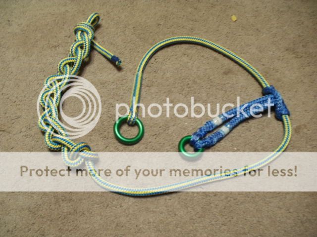

Check out this sexy custom cambium saver.

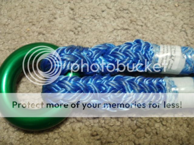

splicing credit goes to wesspur. i chose to go with arb master cause its a cover dependent line so i could see the visible wear and tear. chose DMM rings because they are super light and very strong and when spliced into 3/8 tenex you got yourself an awsome adjustable cambium saver
It looks like the tail of the line is cut and whipped.
My preference would be to have something more substantial on the end as a stopper.
Like...
Backsplice
Stitched eye
Seized eye
Stopper knot
hey Josh,
I agree with the two other post and I'll add another thought: with the plain end, you potentially have a safety issue for the prussik. Are you always gonna tie a stopper behind it?
Just a thought: kill both birds by having Wesspur add a ring on the end ... ?

Its a nice Cambium Saver Josh! But there are some worthy concerns that have been brought up. I would have the 3rd ring installed on the Cambium Saver, and then you will have a more useful Cambium Saver, and a safer one too!
Either way it will do its job, and treat you well. Just don't forget that stopper knot in the end of your adjustable Cambium Saver.
guys calm down. ;) i have a double overhand stopper on it, i just daisy chained it when i took it outta the box to make it fit into the photo. 10 feet is hard to fit in. i decided to not get the 3rd ring because im using it mainly for palm tree descents and for spar work. i have never had a need for a 3rd ring. please add your input on using a 3rd ring. pics too! :)

Joshua I only have one question.
Did you get the AFS shipped to you by Wesspur without a firmly set stopper knot?
I know you wouldn't use it without one, but that item will also be shipped to less experienced climbers.
This is probably a safety issue that has to be discussed with their splicers.

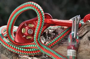

I can't figure out the sexy part about this regular friction R&R saver.....
I'll just add a pic of one that looks much better to me ;-)
