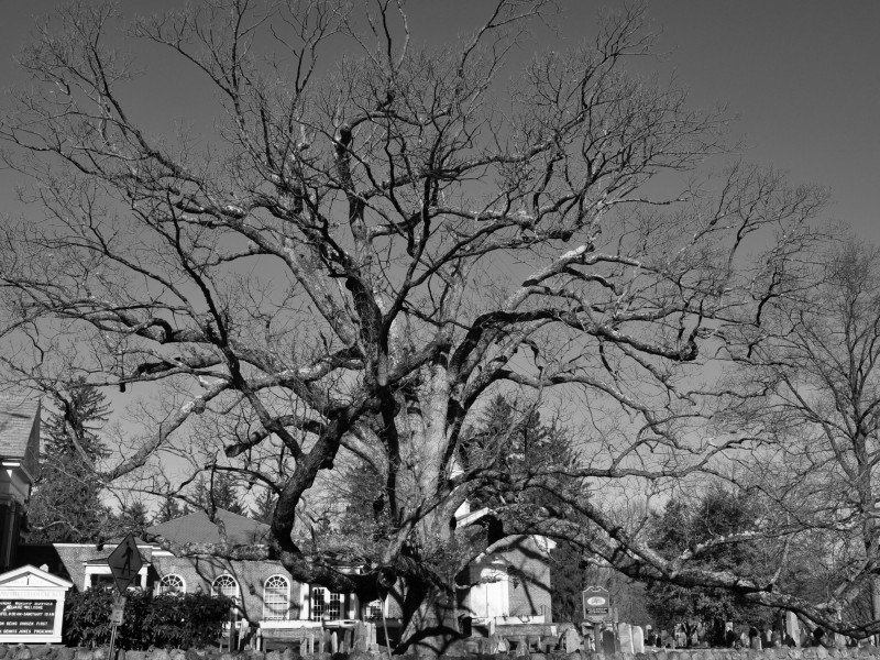

Cabling and bracing can sustain a tree for decades and longer. There's supposedly 1500' of cable and 170' of rods in this oak in Basking Ridge. Not at all unsightly or even noticable.
Thanks guys! I was hoping someone might have some info about big bracing, and that photo is wild, and makes quite an impression, what a great tree!

It's also got a few props on the lower limbs. That work was done in 1924. The tree is reported to be 600 yrs old. It was huge when Washington wandered thru there, Jockey Hollow being just north of this.
I have an aunt whom resides 5 minutes from jockey hollow . I'm gonna have to stop by that tree .. Is it on a church property do you know by chance?
