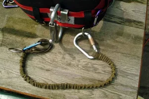

I put pear-shaped carabiners on both ends of a 40-something inch break-away lanyard, strapping one end to the left loop in the rear of a Bfly-II. I used to direct attach it (via webbing loop) to my climbing saw but it got in the way when using the saw on the ground and then I'd need one per saw.
The extra length with the biner on the belt hook puts the saw lower on my hip. It seems to be more accessible, contrary to my previous thoughts on adding it there. More distance between me and the occasional kiss of the muffler.

I use Black Diamond 'Ice clippers', and a cresto tearaway bungee lanyard - guaranteed to fail at 200kg, not under not over. And the ring sits right against the handle, which would make for quicker clipping onto Ekka's hooks. With a 338, it also allows the saw to sit tight and comfy against the arse with the muffler away, no sharp angles or spinning.
