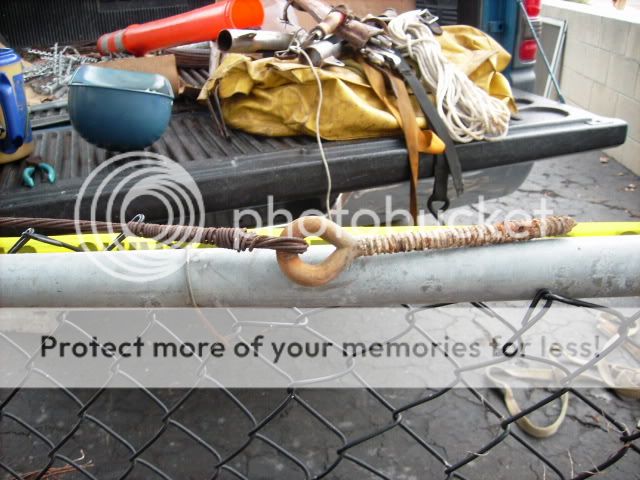

Because they pull out under load more often than not, the wood is too soft for the threads to hold long enough for the lag to be engulfed by new wood.
jomoco
One of the hundreds of J lag failures I've replaced with proper throughbolts over the years,

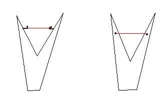

With all due respect Kev, without knowing the J lag's angle of path into the wood, your graph makes no sense.
The closer to exact alignment you can get between the cable lay and hardware terminations in a straight linear line, the stronger your installed cable will be.

sorry Kevin, but that drawing isn't showing me anything either.
It's like, what is different here? aaaah, one has j-lags and one has dots.....
i thought i knew what you were saying from the beginning, now the diagram shows me i have no idea what you are talking about.
The term perpindicular was improper in terms of load.
Perpindicular lines meet at a 90 degree angle, therefore they would only apply to cabling other than triangular reinforcement of a weak or flawed wood union point.
