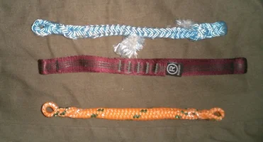

Regarding the bridge of the saddle, I thought I'd share with y'all the last three bridges I used.
The top one in the photo is one I had for a couple months. It's Yalex. It worked fine, but because it is a loose rope, I was splicing something so short, and the application caused to rope to be constantly bent at various angles, the tips of the buried, tapered tails were popping out the rope. The cover strands were still undamaged- but the whole thing was unsightly. Not only that, if something DID happen to the cover strands, I might not notice it thinking it was just core strands popping out. So that had to go.
I switched to the next one on the list. A 22kN presewn sling. I sewed the ends down to form tight eyes. This worked fine with 2 exceptions: 1- it was a bit too long. 2- when the carabiners would run over the bar-tacked/sewn area, there was a bit of resistance. Not that big of a deal, but not as smooth as I'd like.
That led me to number three. This is the cover of 1/2" Double Esterlon. I haven't used it yet, but I think this might do better that the first two. You know I'll keep you updated!

that's 1/2" double esterlon. Typically it'd be impossible to splice the two ends that close.
I took the core out and braided the cover as if it were a single-braid/hollow braid.
I think I could get near 6" short with this little trick. I don't recommend doing this. This is not endorsed by any manufacturer. Doing this WILL kill you immediately.
