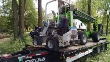

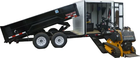

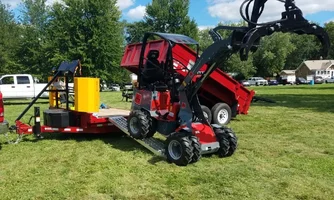

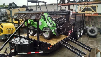

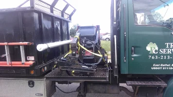

Platform Trailers and other Ideas

That guy dumps that box with the machine in there.
have to have a nice level dumping yard :estudioso:
great Idea, but scary in a potholed - mucky dump site
I was referring to the Isuzu FRR with the Toro: that pic with the little Avant looks too be too much of a good thing.
What's the Benefit of dumping the loader too?
