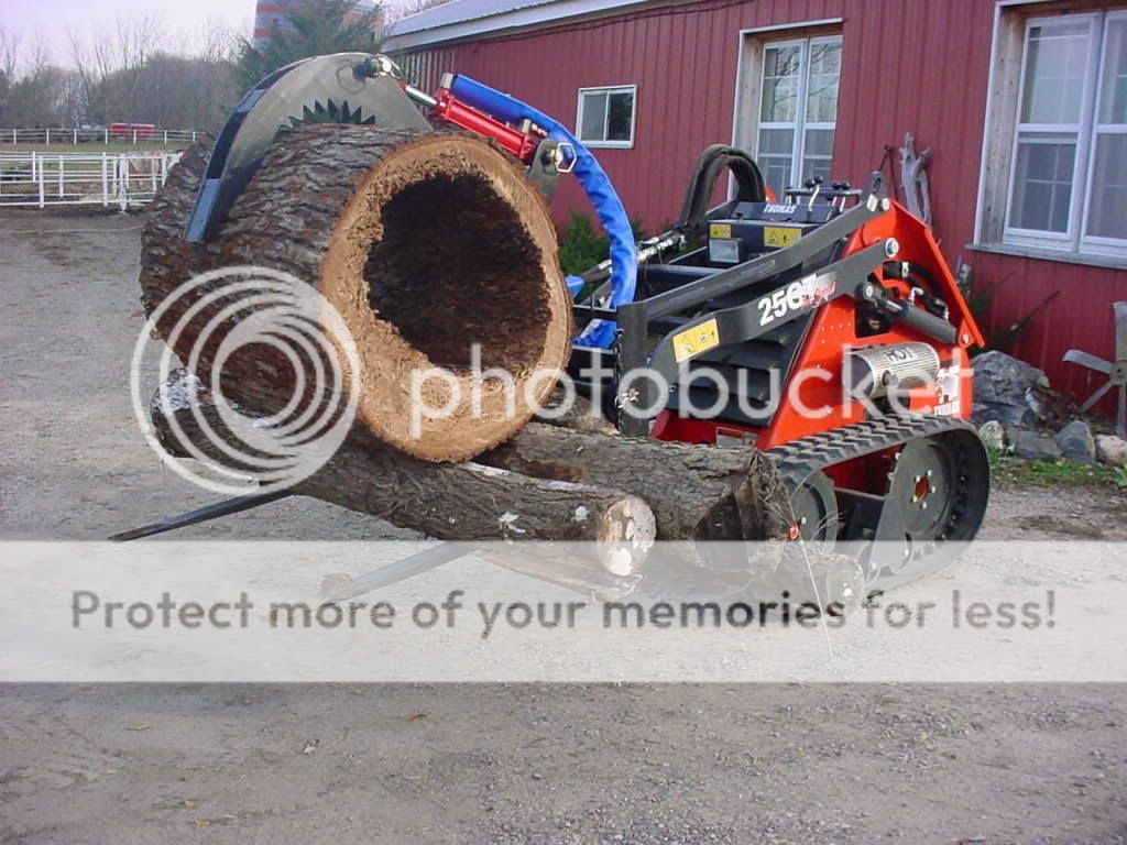

Man, that's weird. I was about to ask the same question out of the blue. (what happened to the beak?) I'm guessing it just didn't sell enough, or maybe supplier issues. Seems like a great tool. I could be wrong, but it looks like it would be a lot better for brush piles than the grapple, and it can hold a ton of logs horizontally. Long time ago I found a pic online of a Thomas with the beak holding a log that looked as big as the machine. Had to be 36" plus and 3 feet long.

My first Beak Kinda died - forks are handy now and then, and log loading, brush is great if you have big acess, doesn't feed a chipper worth a _____
The last beak - my design Forks were 2 wimpy (#900) for the newer more powerful minis
Still can get this one, (#2000frks) I pull the bolts and put in 1" hitch pins - so you can remove the Beak
http://www.youtube.com/watch?feature=player_detailpage&v=HaU9WQBIV4Y
Got to be the worst video I ever made can't even see the Beak
Yep, that's the pic I remember. Forgot the log was hollow, but still an impressive load, with room on the forks for more.
