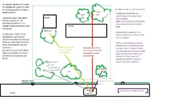

By the way, If I was doing that job, I would inquire about a 200 Ton if it wasnt a lot more dough.
I always like having the ability to go bigger when needed.
However, depending on your landing zone, you may not be able to squeeze big pieces into a tight area.
Ohh,,, that is one other thing.
see if you can just shut the street down for the day.
If you can re direct traffic around the block and have the whole street to play in, it will save a ton of crane time.
