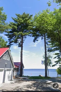

Bid that tree!
Does it overhang the house?
To me, an important aspect of this thread is contact 'spec' phrasing. How would you write this job in your contract?
It’s about 15’ from the home and leans towards it, plenty of limbs and tops are over or near the plane of the home
That would be a $5000+ tree around here for any reputable company.
I was thinking it was a 4-6k tree.. it’s not really a difficult removal, with ample space to work and plenty of room between the big limbs and the roof but gawd it’s a girthy trunk and plenty to deal with.
I can’t possibly remove this one since I have 0 equipment but I gave them a cut and leave price of 2645
Ps, there is room to drop the final stem 30-40’
I say $3250, but my wife would take that and tell me to put another grand on it. She knows me too well. We joke that she should do the bids. Well, she jokes. I’m serious.
I'd probably rent a crane for about 2k and then want 3k for myself, so 5k. If I'm rigging that out I'm probably going 6k. With the lean toward the house everything is going to end up coming down over top of it or closer to it. A lot of screens and windows there....
Possible friggin around with speed lines or taglines.
Or you could go full cowboy and take it in 4 or 5 pieces pulled into the open area.
No matter what that's a shitload of material to move and dispose of. That's where most of the cost comes from.
Just expanding on my perspective.
If that tree is really 100' tall and 42" DBH, it should be at least $4k. That is a lot of material. I think I would bid it at $5k. Our mini is so small it would have to take the trunk wood in 36" pieces and that's lots of pieces
If we could get a crane near it, we would lift it out of there in a couple pieces, probably $2800 and one of the local hacks would charge half that and get the job.The logs have value, they would pay for their own trucking at least. Seems like a project that would take about two hours on site.

For comparison sake, here are two large pine I've done in the past couple of years.
This one was ~100ft and 36" DBH. No cleanup. $3000
The one closest to the house here was ~80ft and 28" DBH. Full cleanup. $4000
I know the photo doesn’t do it justice, wide angle lense is great for fitting the whole tree in the frame but awful for showing scale
Pics with a person close to the tree for scale, or a known-size object that's available, would help.
How is access in and (loaded) out?
Distance to shop?
Disposal method?
