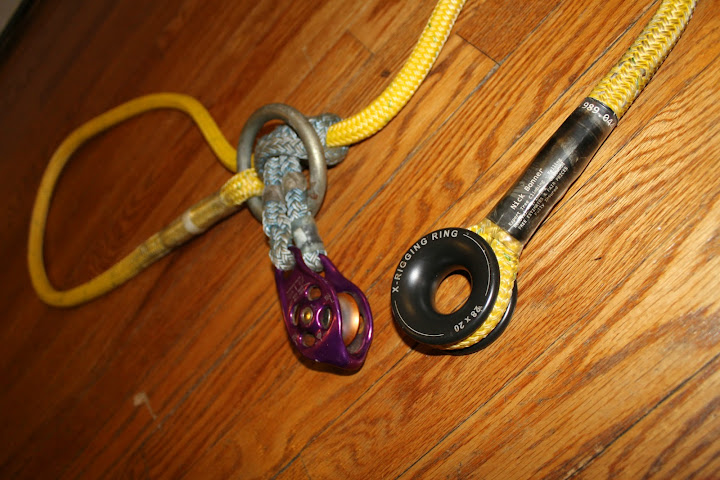

XRR say always use 3 rings as a terminal rigging point, however pinto,buck blocks, r&r friction saver with 2 1/2" thick rings and we rig some decent pieces has anyone ever tested different systems to break like Xman did? what were the results?
This is a Beast XRR and a Large 28/20XRR compared to ordinary tools. THis is great because it works like a R-r friction saver and is retrivable with an overhand knot and 1/2 line.
I wont say bend radius isnt a real factor to consider but I think people sometimes unnecessarily make too a big deal out of it.
Here is a 28/20 and a Forged 1/2" Rigging ring. I use this basket in basket and choking setup all the time. So with or without the 1/2" steel ring.
Here is a 20/14 and a pensafe ring. This is definitely lighter duty but still very capable.
This is 2 28/20 rings, I rigged some ridiculous stuff off of this and it was great in the bucket. Retrievabilty wasnt awesome so I took it apart after I amde the bigger one shown above.

This is my everyday rig. I use it for almost everything. I have negative blocked some big wood onto this guy. The black rigging ring can be used to equalize two TIPS or as a retrieval for choked config.
The Pinto pulley (since respliced onto 10mm TVP) chokes through the big ring like a Pulleysaver or Tom Hoffmans uSAVER.
